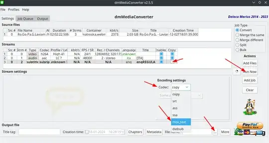

As a GUI for ffmpeg there is this tool: dmMediaConverter.
Very easy to use, but with subtitles I had to edit the subtitle codec and change to mov_text.
