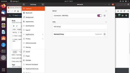

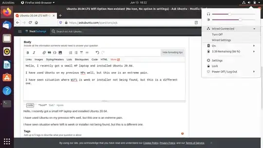

Thing about my laptop is that it doesn't even have WIFI as a Network option as demonstrated by three screenshots below. Most of others' problems relate to situation where 1) their wifi is too weak 2) Wifi is in questions mark 3) Wifi option is not in GNOME but at least exists in Settings toolbar.
In my case, It's in NOWHERE. Not in GNOME Not in Settings

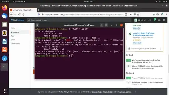

Edited section : screenshot of rekill command and lspci command rfkill and lspci command
In addition, rfkill does not even list Network Controller but only lists Bluetooth as result (wifi definitely worked in windows) Has anyone seen this issue before?
