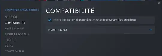

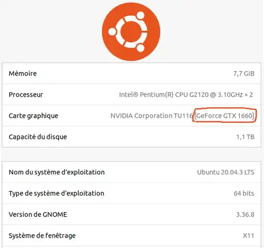

I bought and installed a new Graphic Card NVIDIA GeForce GTX 1660
and retried to install DCS with Steam and Proton 4.11-13.
And it works perfectly.
My previous Graphic Card was probably not powerful enough.
