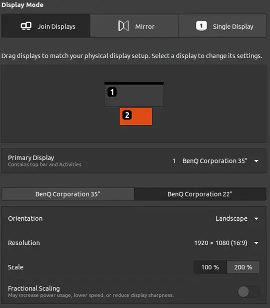

Here is my display setup:
displays

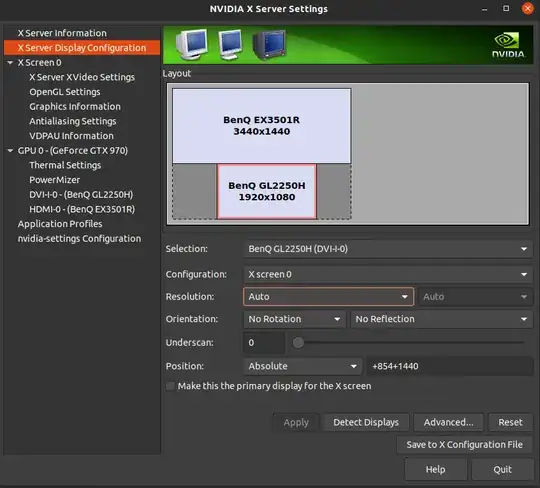

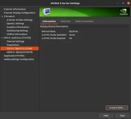

I also couldn't find an option in the NVIDIA X Server Settings: nvidia x server settings
nvidia monitor

As stated here you can use cvt and xrandr to change the refresh rate of your monitor.But in your case the arguments of the cvt have to be 3840x2160 24 to limit the refresh rate of your second monitor while preserving its resolution.

  • See which processes are putting a high pressure on your GPU via nvidia-smi or nvidia-settings(i.e the program the screenshots you posted belong to) and limit the CPU usage of them via cputool as follows (you have to install the cputool package first) :
