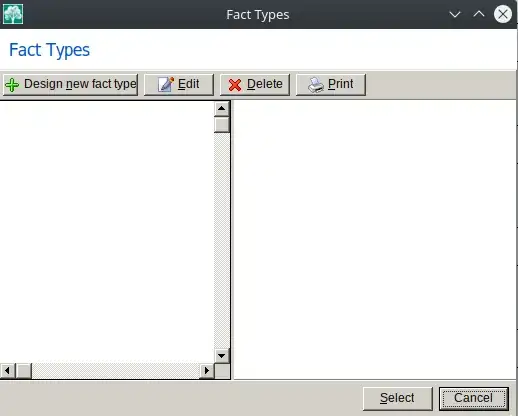

The window for "add fact" is frozen after selecting a type of fact to add. All of the fact types disappear and the window freezes. All of the other buttons work on the frozen window, except "cancel" and the program is stuck. The system must be rebooted to get it to close.
Frozen Window

I followed these instructions to get Wine updated, on my Kubuntu 20.04 install:
How to Install Wine 5.12 in Ubuntu 20.04 / Linux Mint 20
After following the instructions, I launched my previous RootsMagic 7 Wine, and it updated, and successfully updated mono and gecko... and now it works.
