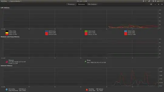

While installing Ubuntu 18.04 LTS I created swap in hard drive which is leading me hang for heavy applications because I have 8 GB of RAM.
