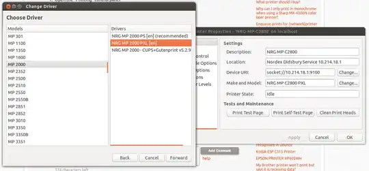

Roadmr is correct although I have had personal experience with this and you should be using the PXL driver as I show below. I know this is the case for the MPC 2000,3000,5000 and there many variants.
Ubuntu will automatically detect the printer but select Postscript, I have to after installing a printer go into the printer settings and manually choose a PXL driver as shown here.
  1. choose printers from the dash.
  2. right click on the printer and go to properties.
  3. choose change make and model.
  4. Select NRG -> MPC 2000 PXL
You should then be able to print and not waste a tree of paper.
