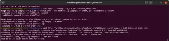

I am attempting to install Packet Tracer on my machine running Ubuntu 20.04, and I keep running into the same issue. While going through several different tutorials on installing Packet Tracer 7.2.2, I run into the same problem: I keep getting the 404 Error message when I get to the part of adding multiarch-support. The line in terminal that is causing me the errors is:
wget http://archive.ubuntu.com/ubuntu/pool/main/g/glibc/multiarch-support_2.29-0ubuntu2_amd64.deb
Does anyone have any idea how to correct this? Or what am I doing incorrectly? Thanks for the help!
screenshot of terminal

I had a similar issue with 3rd party software. The latest file I found worked for me:
  1. download the file
    wget http://archive.ubuntu.com/ubuntu/pool/main/g/glibc/multiarch-support_2.27-3ubuntu1.2_amd64.deb
  2. install with dpkg:
    sudo dpkg -i multiarch-support_2.27-3ubuntu1.2_amd64.deb

You can enable multi arch support by issuing this command in a terminal dpkg --add-architecture <arch>(replace <arch> with the architecture you want I use i386 most often.)
