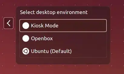

I've set up the same. I'm providing you an easy script. Run this script and you will able to use a web browser with their site in full screen. No address bar, no button, user can only click the link on the page.
wget -q -O - https://dl-ssl.google.com/linux/linux_signing_key.pub | sudo apt-key add -
sudo sh -c 'echo "deb http://dl.google.com/linux/chrome/deb/ stable main" >> /etc/apt/sources.list.d/google.list'
sudo apt-get update sudo apt-get install google-chrome-stable -y
echo '[Desktop Entry]
Encoding=UTF-8
Name=Kiosk Mode
Comment=Chrome Kiosk Mode
Exec=/usr/share/xsessions/chromeKiosk.sh
Type=Application' >/usr/share/xsessions/kiosk.desktop
echo '#!/bin/bash
xset s off
xset s noblank
nm-applet &
sleep 5s
while true; do
    google-chrome --window-size=1920,1080 --kiosk --window-position=0,0 http://google.com;
    sleep 5s;
done' >/usr/share/xsessions/chromeKiosk.sh
sudo chmod +x /usr/share/xsessions/chromeKiosk.sh
Copy this all content in an .sh file and run it. After the completion of the script you need to login in Kiosk Mode as shown in the image.
Kiosk Mode
