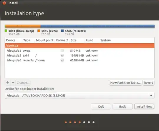

I am a newbie for Ubuntu. Existing partitions in windows were - C,D and E. I choose "something else" option while installing Ubuntu from pendrive. In the "installation type" step, I have selected /dev/sda2 (C Drive) to format and use as ext4 type to install Ubuntu (mount to /). I have selected "Device for boot loader installation" (see image below) also as /dev/sda2. Created swap area of more than 4 GB. I did not touch other partitions (D and E). I didn't create any specific partitions to mount /home or /boot as I have no idea about them.
Installation was successful and it asked me to restart. After restart, windows boots and says some error occurred with Windows. It there any way to boot Ubuntu? Did I mess up installation?
This image is just for reference of the installation step, not the actual image captured during my installation

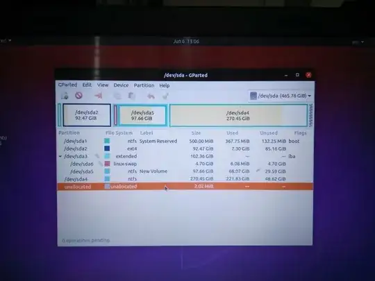

Gparted view after ubuntu installation. (Obtained by booting from pendrive and selecting Try Ubuntu)

The mistake was selection of /dev/sda2 for "Device for boot loader installation". Ubuntu was unable to boot automatically.
I reinstalled by selecting "/dev/sda (harddisk name)", Ubuntu installation is successful and it boots upon start.
In short, my goal was to replace existing Win10 OS (present in Drive C:) with Ubuntu 20.04 while retaining all my data stored in other partitions of the disk (D and E).

For "Device for boot loader installation" select /dev/sda (harddisk name), this is the default choice. This step is very important. If you choose some other option here, Ubuntu may not be able to boot even though installation is successful. This is where I did mistake and hence suffered a lot trying to find why Ubuntu doesn't boot even after successful installation
