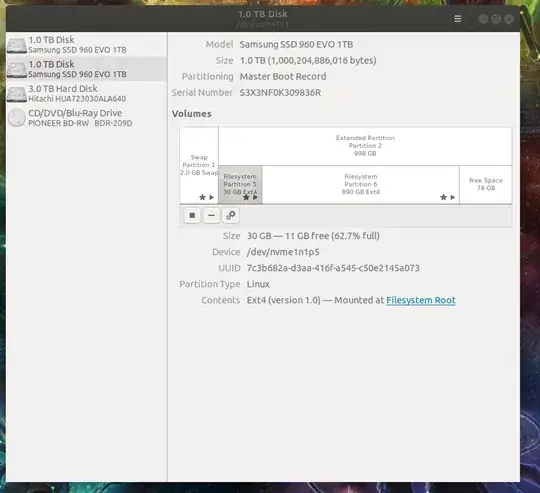

My root file system has recently become full, and I was hoping to allocate some more space to it. In the picture linked below, Partition 5 is my root file system, but I am unable to add the 78G that I have free to it. I have tried booting from a usb drive and modifying it through the build in disk utility, but that it just would only let me decrease size. I am aware the picture says there is memory available, but this was after I nuked docker images and reinstalled it. It is currently at no space available.
Alternatively, is there a way I can make docker user memory from my filesystem with more memory?
Current Partition Allocations:

Make sure that you have a good backup of your important Ubuntu files, as this procedure can corrupt or lose data.
Keep these things in mind:
  • always start the entire procedure with issuing a swapoff on any mounted swap partitions, and end the entire procedure with issuing a swapon on that same swap partition
  • a move is done by pointing the mouse pointer at the center of a partition and dragging it left/right with the hand cursor
  • a resize is done by dragging the left/right side of a partition to the left/right with the directional arrow cursor
  • if any partition can't be moved/resized graphically, you may have to manually enter the specific required numeric data (don't do this unless I instruct you to)
  • you begin any move/resize by right-clicking on the partition in the lower pane of the main window, and selecting the desired action from the popup menu, then finishing that action in the new move/resize window
Do the following...
Note: if the procedure doesn't work exactly as I outline, STOP immediately and DO NOT continue.
  • boot to a Ubuntu Live DVD/USB, in “Try Ubuntu” mode
  • start gparted
  • move /dev/sda6 partition all the way right
  • resize /dev/sda5 right side all the way right
  • click the Apply icon
