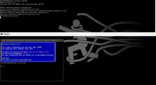

On my box, when I installed via software center it put a compiled binary in /usr/bin like this:

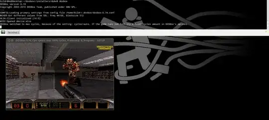

Which gives us this:

Now when I double click an exe it tries to load in dosbox, as it should since I installed that last.

You don't launch things in Dosbox with shortcuts. You load up dosbox and run them. At least that's what I do, and it works for me.
