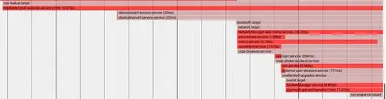

The problem is resolveconf-pull-resolved.service and plymouth-quit-wait.service are taking a lot of time to start making the overall boot process slow. The first one upon searching, I found various issues where it caused the boot to stuck there but none where it caused the boot to be slow overall, for the 2nd one I found this answer which says that this service is not at fault as it just waits for others to complete.
The whole process of my investigation is explained below:
systemd-analyze time gives the following output:
Startup finished in 7.870s (firmware) + 3.118s (loader) + 19.467s (kernel) + 1min 56.978s (userspace) = 2min 27.435s
graphical.target reached after 1min 56.840s in userspace
Upon following this answer regarding slow userspace, mine problem was similar (meaning snapd was one of the main culprits for slow down ) as systemd-analyze blame | grep snapd gave the following output:
26.656s snapd.service
      1.011s snapd.apparmor.service
       915ms snapd.seeded.service
         1ms snapd.socket
and systemd-analyze blame | grep dev-loop gave
10.384s dev-loop19.device
     10.236s dev-loop9.device
     10.155s dev-loop0.device
     10.151s dev-loop16.device
     10.110s dev-loop14.device
      9.776s dev-loop13.device
      9.470s dev-loop15.device
      9.294s dev-loop12.device
      9.106s dev-loop6.device
      8.982s dev-loop17.device
      8.873s dev-loop11.device
      8.864s dev-loop10.device
      8.738s dev-loop8.device
      8.731s dev-loop18.device
      8.724s dev-loop21.device
      8.052s dev-loop3.device
      8.017s dev-loop2.device
      5.861s dev-loop5.device
      5.374s dev-loop1.device
      4.883s dev-loop4.device
But if we look at the whole plot in the svg file ( I have posted the link as uploading the whole image here would make it unreadable because of the size compression ) resolveconf-pull-resolved.service and plymouth-quit-wait.service still take more time than them. Below I have posted a screenshot showing the relevant section of the svg file.enter image description here
