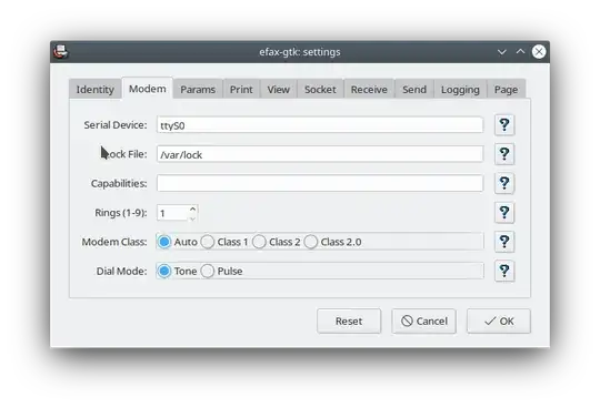

Settings of efax-gtk look like this

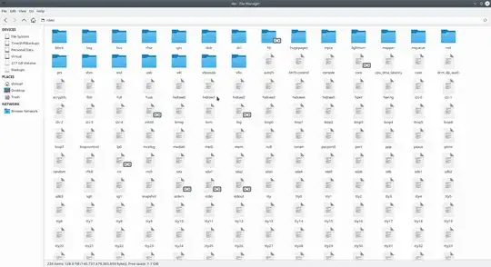

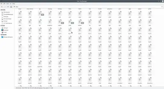

/dev looks like this

It's been some years since I did this process myself (also on Kubuntu, fortuitously), but a quick glance at your screenshot shows an absence of either dev/modem or dev/ttySHSF0 is suggesting to me that you either haven't installed the kernel module for your device, or if so then it is failing to load. I'm not sure what your thought process was regarding the sl-modem-daemon (for SmartLink chipsets, not Conexant), but I would start by uninstalling it.

5/ Open efax, file menu,settings, and enter the ttyS0 as the port to use.
