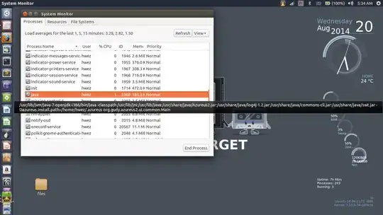

or you can use "system monitor" enter image description here
this picture shows you that "Java" is running App name "Azureus" ("Vuze" is an app made by "Azureus")
after killing the process the you can open "Vuze" again
