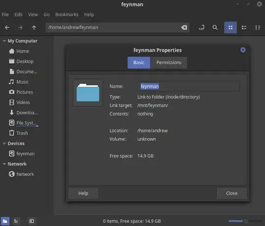

From folder browser checking properties shows that volume is unknown
Volume of drive shows nothing
