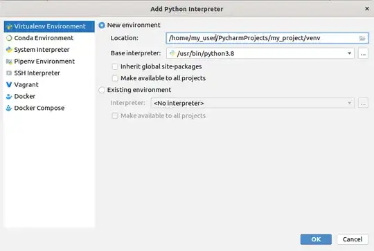

So for me in Settings -> Project -> Project Interpreter and then from the perspective when clicking on Show All... and adding a new one - you should see something like that:
So in my case was sufficient to change Base Interpreter from /usr/bin/python3.6 to /usr/bin/python3.8
