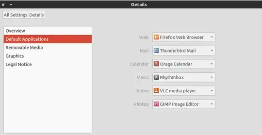

Go to >> System settings>>Details >>Default Application enter image description here

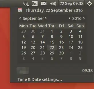

Ubuntu 16.04 has a calendar that you can view just by clicking on the time and date in the top right-hand corner of the screen:
Screenshot
If you install GNOME Calendar (sudo apt install gnome-calendar), you can create events, and they will appear in this widget.
