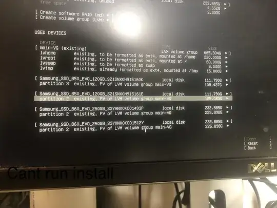

I scripted my partition and LVM scheme for my last installation (that was of Arch Linux)
I now want to switch to Ubuntu, but use the same scheme that I used before, which was separate pairs of mirrors for /home and /
However, the Ubuntu installer does not seem to allow me to use existing partitions. Is this possible with the Ubuntu installer, or do I have to do it through the interface. And can I script it somehow?
Edit: I realized I forgot to set the partition table of my usb as GPT, maybe that is why I couldn't select done even after adding the desired partion as /boot
Edit2: I remade the usb with a GPT partition table, but while I was able to see the EFI partition I had previously made, but was not able to get the installer to use it.
And if I can't use my pre-existing partitions, can I at least do something equivalent to the "alternative" installer approach in Ubuntu 18.04? I recall this worked for me before: Install Ubuntu 18.04 desktop with RAID 1 and LVM on machine with UEFI BIOS
This is the partition scheme that worked for me under Arch and I was hoping to use with Ubuntu:
