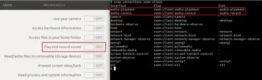

If installed using snap package: It's worth noting that even removing "Play and record sound" from Permissions on Ubuntu software it's still can play and record sound. IMO a serious security bug on snapd/snappy/snap-store. Maybe this wouldn't happen on Wayland?
Also, audio-record connection (AKA interface) shouldn't auto-connect, but people behind snap store override this rule on purpose.
screenshot

Zoom is available as a Snap: snap install zoom-client
Snaps are confined to their own filesystem using squashfs loop mounts and AppArmor rules. However, Zoom needs routine access to quite a lot of your hardware (USB ports, audio, screen, camera, network) in order to be useful. Also, the application needs to be detectable by others on the system (so e-mail invitation links work). So complete sandboxing seems a challenge.
Some problems with Zoom (like the ability to bruteforce an access code) are outside the OS' control.
