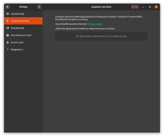

See it is enabled in Settings:
pic1

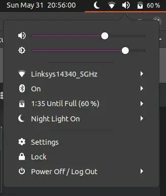

But my top bar does not have the location icon that used to show there:
pic2

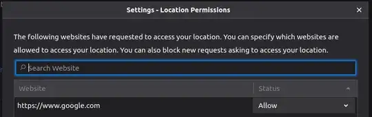

And services like Google Maps do not seem to be able to retrieve my location. See below in Firefox, even though I allowed it...
pic3
pic4
