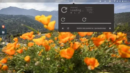

From yesterday, openweather extention on the top panel does not show the weather. Its shows "Please wait Loading".
I tried to find the solution. There was a post of creating account on openweather website and use API id. I found that it is a subscription base plan. There was a free plan which allows 60 calls free for weather data.
I thought that the extention is open source. And may be I deleted any package that is required to work the extention so I reinstall the OS. But there is no difference of doing that. enter image description here
What could possibly go wrong any guidance?
