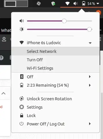

I want to set a shortcut to open the Select Network dialog that opens from the top left system menu. The graphic way to open it is to click on the top left corner, then on your network, then on "Select Network", like below.
Graphic way The dialog I want to open

  • I have also tried to write a script with xdotool but this is inconsistent as it needs some sleep because I pass through the super+F10 shortcut and then move in the top bar to reach the Select Network item.
    The script looks like that but I don't really think it's relevant.
    #! /bin/sh
    xdotool key super+F10
    sleep 0.6
    xdotool key Right
    xdotool key Right
    xdotool key Right
    xdotool key Right
    xdotool key Right
    sleep 0.3
    xdotool key Down
    xdotool key Down
    xdotool key Down
    xdotool key Return
    xdotool key Down
    xdotool key Return

You probably are looking for text-based tools like nmcli or nmtui, they generally ship with most distros and it's part of the NetworkManager package. They both have the hability to provide some sort of a shortcut after creating the connection.
