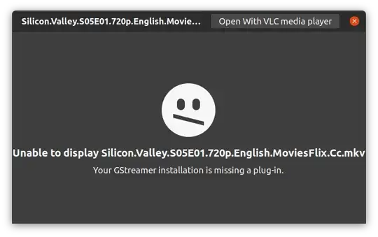

I have GNOME-sushi installed on Ubuntu 20.04 LTS. Initially when I selected a video and pressed spacebar, the following error occurred.
After installing the gstreamer1.0-plugins-bad and gstreamer1.0-plugins-ugly packages, only the audio is played but not the video.

How to install the missing plugins?

Install 3 packages by the command below:
apt-get install -y gstreamer1.0-gtk3 gstreamer1.0-pulseaudio gstreamer1.0-libav
It works for me on Ubuntu 20.04.
