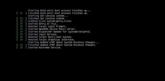

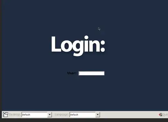

I'm trying to install lxde desktop on a remote Ubuntu 20.04 server and VNC in.
When I use a ubuntu 19.10 server I have no problem:
#USING 19.10
sudo apt-get install -y lxde xorg lxdm  --no-install-recommends
#or
sudo reboot
Using VNC it works just fine to access the GUI in 19.10
#USING 20.04
#or
sudo reboot
Hangs here and retries in infinite loop in 20.04:
Can someone tell me what the difference is and help me solve this?
