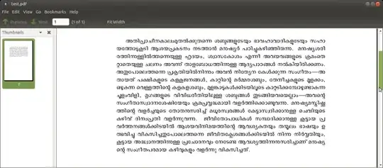

run LaTeX
pdflatex test.tex
and see the output:
xdg-open test.pdf
mm pdf
