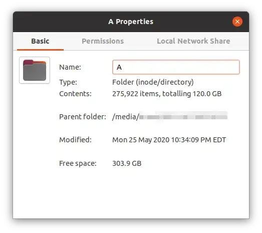

All (including hidden) items
I have tried tree -a inside the directory we care about, which gives:
28949 directories, 246973 files
This means tree -a gives 275,922 items total.
Nautilus gives 275,923 items total, assuming I have toggled on the "show hidden files" option for Nautilus; this is a match, since it is okay for us to add one to the result from tree -a.

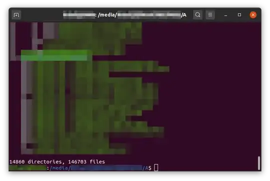

I have tried tree inside the directory we care about, which gives:
14860 directories, 146703 files
This means tree gives 161,563 non-hidden items total.
Nautilus gives 160,829 non-hidden items total, assuming I have toggled off the "show hidden files" option for Nautilus; also, even after adding one to the result from tree, the two counts from tree and Nautilus are slightly different.

  1. All (including hidden) items via Nautilus:

  4. All non-hidden items via tree:
