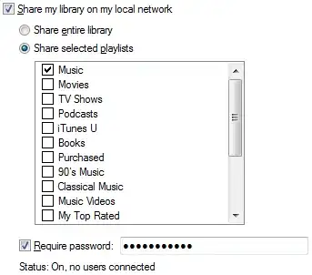

I've confirmed that sharing is enabled in iTunes,
iTunes

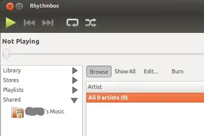

and that the share is visible in Rhythmbox,
Rhythmbox
so I believe the problem is within Amarok.
