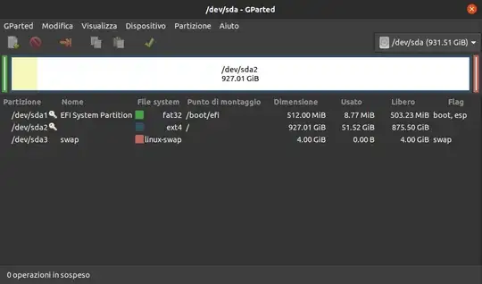

A friend of mine told me it seems a problem of swap. I noticed that my installation didn't have a swap partition so I created one and activated it with GParted on a live USB:
Screenshot of GParted on my PC
I don't really know what that EFI partition is for, but I noticed my PC has secure-boot enabled and no option in BIOS to disable it, so I wonder if there's some limitation built into the computer.
Adding the swap partition didn't change much, and I didn't add other partitions as like /tmp and /home. Boot time lowered a bit and the critical chain before adding swap was different.

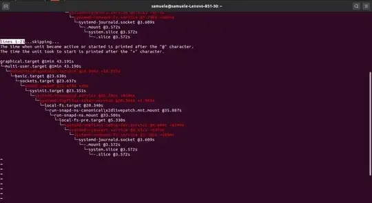

Critical chain before adding swap partition:
