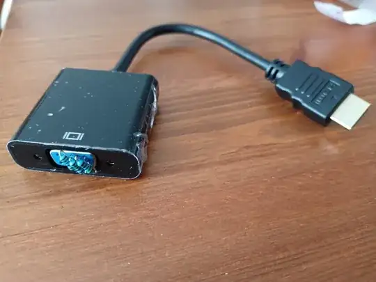

Dummy VGA to HDMI solved the problem.
Description here:
https://www.geeks3d.com/20091230/vga-hack-how-to-make-a-vga-dummy-plug/
This one I have made
