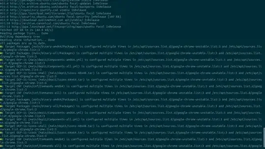

After checking for updates with sudo apt update I get the following errors (maybe they are warnings).
How do I deal with them? And what is the cause.

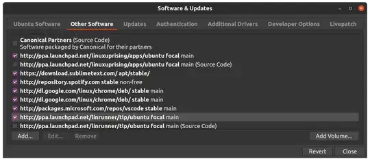

Also I can see two chrome PPAs in Software & Updates. enter image description here
Is that somehow related to this incident? Is that a problem, having two same PPAs.

Yes. It clearly says that chrome source list have been configured multiple times. Just uncheck one of them.

This error can be removed by simply deleting the files using rm -rf /etc/apt/sources.list.d/google-chrome-unstable.list* command.
Each time you install an app, a link is created to its repository (or PPA), which are stored here. But when you uninstall a package, it doesn't clear itself from this location. Since chrome and chrome-unstable are from similar locations, hence the error (since both are contradictory). And hence you need to remove these files for chrome-unstable from this location.
These files are also visible in the Software & Updates, hence removing the file from here remove it from Software & Updates also.
