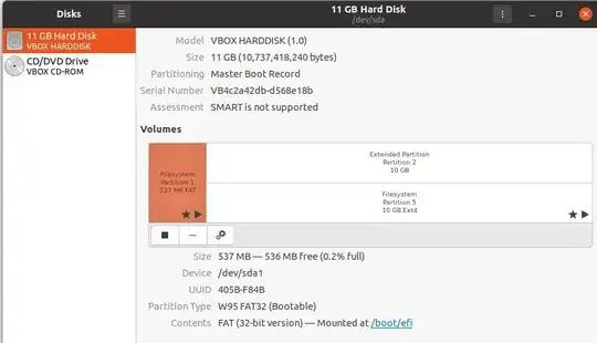

You can install it in as little as 11. My Ubuntu VirtualBox install of Ubuntu 20.04 runs well on 11 GB. Not much space left over but runs well for testing. 15 is better if you have the space.

@Tatsat Dave, my normal Ubuntu 20.04 LTS installation with Firefox and Chrome browsers and Thunderbird email and normal set of administration tools takes already now 19,5 Gt and in the future years of updates to 20.04 LTS it will take more space. To my understanding type of partition for Ubuntu 20.04 LTS should be ext4.
