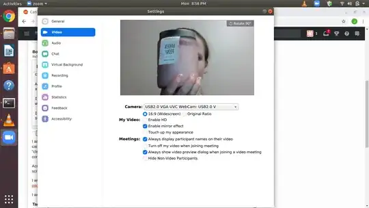

According to the Zoom settings, it is using "Camera: USB2.0 VGA UVC WebCam: USB2.0 V". In the attached screenshot I've hidden my face for privacy, but you can see the list of settings and that the color is working correctly.
Zoom settings and camera example

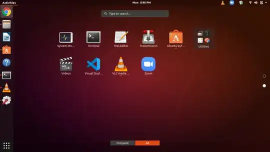

I went to my application list for programs on my computer and didn't see anything related to webcam, camera, etc.
Ubuntu program list page 1
Ubuntu program list page 2

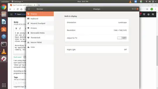

I went into my Ubuntu settings but there didn't seem to be anything there about cameras.
Ubuntu settings list

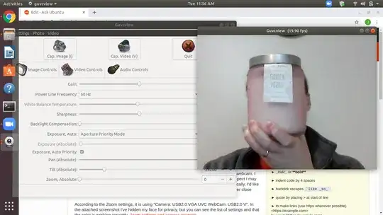

Edit: Hi @sc608, I installed guvcview as you suggested. However, when it installed the video was already zoomed out all the way, as shown here
gucview screenshot
and my face is not any larger. The Zoom video still looks the same unfortunately.

I am not sure if it will solve your issue with Zoom but the package guvcview contains zoom controls for most webcams. The package is in the Ubuntu repos and can be installed with sudo apt install guvcview. Once installed it will appear in your list of applications.
The application launches in two windows. One window is the view from your webcam the other is an extensive assortment of webcam controls including zoom. I hope this helps solve your issue.

I had the same problem. The solution was to change a setting in Zoom. Zoom then respected the tweaks made in guvcview, including camera zoom.
Zoom > Settings > Video > Camera > Original ratio: Checked
OP screenshot shows the opposite setting (Original ratio: Unchecked).

I also have this problem. Using guvcview normally works as mentioned by sc608 & james-h. However in Zoom the behaviour is erratic. It seems that when changes happen in Zoom (eg someone new enters the meeting, or a breakout room) the image from my webcam changes back from the original ratio to full zoom. I have to manually go to the settings, turn off "Original Ratio" and then turn it back on again. I'm not sure if this is an issue with guvcview or Zoom.
