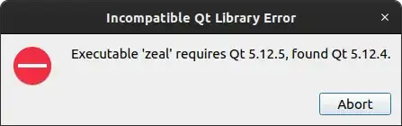

Some days ago I upgraded Ubuntu from 19.10 to 20.04. After upgrading all things work fine except Zeal documentation browser. I clearly says that to update qt5. But I don't know how to update it. The error message is Executable 'zeal' requires Qt 5.12.5, found Qt 5.12.4.
Error Message

Some of your packages are still outdated - libffi7, libicu63. Please check the error output of sudo apt-get update, check your repositories (should have all pockets - main, universe, multiverse, restricted) and all update channels (focal-updates, focal-secutiry). Then run sudo apt-get dist-upgrade to get all newest dependencies (save error logs if any).
Then use zeal deb-package from the repositories:
sudo add-apt-repository universe
sudo apt-get install zeal
