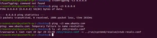

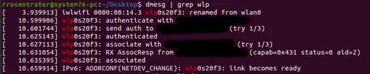

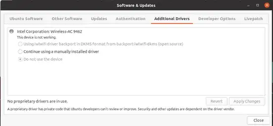

Hi I am trying to set up a new laptop with Ubuntu. For some reason my wifi card doesn't seem to be working. I can connect to the desired access point but I can only get the internet working with a cable, not the wifi. The driver seems to be installed and running but additional drivers is showing the device is not working: enter image description here Here is a dmesg indicating the issue might be firmware? enter image description here I was able to find the official firmware for my card from Intel here and tried adding the file to my /lib/firmware folder like the instructions say but that didn't seem to help...
Anyone see the issue?

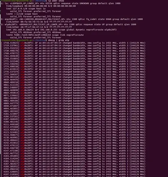

Adding more requested info: enter image description here I do seem to be connected to my desired access point "Wirefly" enter image description here enter image description here ^ There were a couple more changed bandwith messages I couldn't fit in this pic but they were pretty much all the same as the shown ones.

EDIT: We note dozens, perhaps hundreds of lines of:
changed bandwidth, new config
There are many reports of this behavior and it seems always to prohibit the wireless from working at all. Let's try to stop it. From the terminal:
sudo -i
echo "options iwlwifi 11n_disable=8" >>  /etc/modprobe.d/iwlwifi.conf
modprobe -r iwlwifi
modprobe iwlwifi
exit
Is there any improvement? If not, there are other parameters that we may try that are increasingly restrictive.
