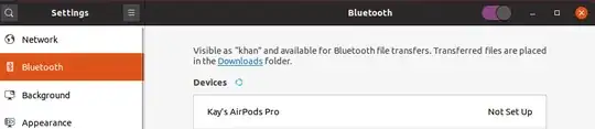

I am using Ubuntu 20.04 and i own a pair of Airpod pro's.
Ubuntu detects the device but fails to pair/setup/connect. I know this because when i click it, it has a spinning logo like its attempting to connect and then it just returns back to the default "Not Set Up".
I have followed advice from here setting the ControllerMode, i have tried both "dual" and "le" without any success.

Short answer is: use ControllerMode = bredr as discussed here
For others:
  1. Set ControllerMode = bredr by editing /etc/bluetooth/main.conf file using sudo nano /etc/bluetooth/main.conf command (or another text editor of your choice)
  2. sudo /etc/init.d/bluetooth restart
  3. Try to pair again.
Stiin
  • 512
Steps to resolve the issue:
  1. sudo nano /etc/bluetooth/main.conf
  2. Set ControllerMode = dual
I had to set dual because my Bluetooth mouse was not being detected if I assign bredr.
With dual I can use both my wireless Bluetooth earphones as well as Bluetooth mouse simultaneously.
Aswath
  • 181
In my case changeing ControllerMode to "bredr" or keeping the default value on "dual" didn't work and AirPods still trying endlessly set up connection.
When i changed ControllerMode=le and restart bluetooth it will connect to pods immidietly.
