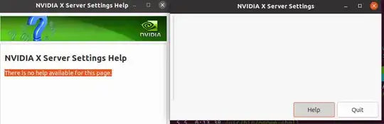

Also, the Nvidia X Server Settings panel is just blank, with the "Help" and "Quit" buttons. And clicking help just says that there's no help:
