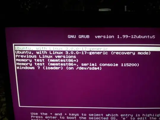

  13. Finally i fix my GRUB problem. Now there is a GRUB menu while booting. enter image description here Previous Linux Versions screen (and dusts) enter image description here

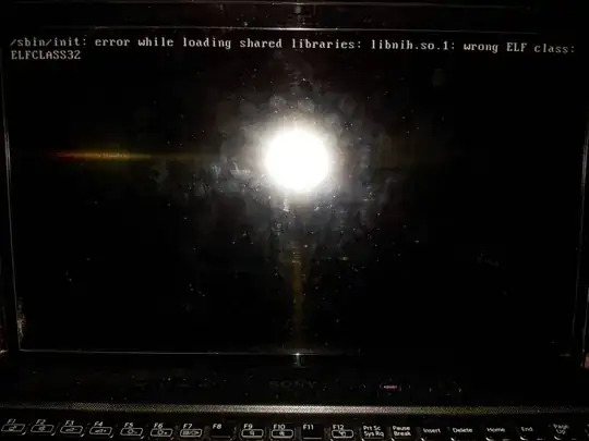

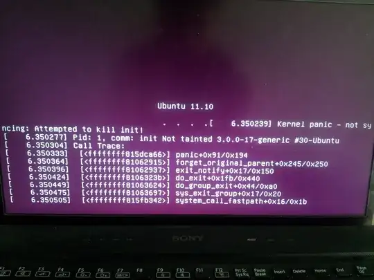

But when i choose Ubuntu 3.0.0.17-generic, it's freezing on loading screen and i'm getting this error : (Scroll Lock and Num Lock flashing.) enter image description here
When i choose other kernel versions -which in previous ubuntu versions screen- , i'm getting this error for both of them.

This time i'm getting same boot error for libnih-dbus.so.... file.
Also for finding other 32bit files, i executed your commands and i see all files in /mnt/ubusda3/lib/modules/3.0.0-12-generic/ and /mnt/ubusda3/bin are 32 bit.
Is it possible to reinstall whole kernel files ?

According to boot-repair paste 938724, update-grub found those entries in your /boot folder when it probed. At least that is what boot-repair found in sda3/boot/grub/grub.cfg.
What do you see in your GRUB menu when you boot? Does it resemble the following?
Ubuntu, with Linux 3.0.0-17-generic
Ubuntu, with Linux 3.0.0-17-generic (recovery mode)
Previous Linux versions
Memory test (memtest86+)
Memory test (memtest86+, serial console 115200)
Windows 7 (loader) (on /dev/sda4)
(If you don't get a GRUB menu when you boot, then try pressing/holding the shift key when the boot process starts to unhide the menu.)
If you see a GRUB menu with the entry Previous Linux versions, try selecting that entry and pressing enter. You should see another menu with entries for the 3.0.0-16 and 3.0.0-12 kernels. See what happens when you boot them.

Curiouser and curiouser. OK, so ELFCLASS32 instead of 64 yet again. Not knowing what else to do, I suggest you follow the procedure you went through during your chat with psusi.
  1. Boot a Live CD/USB for 64-bit (AMD64) Ubuntu 11.10.
  2. Mount and then chroot into your broken Ubuntu install in /dev/sda3. Then run apt-get to reinstall the correct, 64-bit version of libnih.so.1.
    # mount /dev/sda3 as /mnt/ubu2fix
    mkdir /mnt/ubu2fix
    sudo mount /dev/sda3 /mnt/ubu2fix
    # chroot so that '/mnt/ubu2fix' becomes '/' for command processing
    for i in /sys /proc /run /dev; do sudo mount --bind "$i" "/mnt/ubu2fix/$i"; done
    sudo chroot /mnt/ubu2fix
    # reinstall the package which contains libnih1.so.1.0.0 (aka libnih1.so.1)
    apt-get -V --reinstall install libnih1
However, before you do the chroot, you might first want to try to find out just how many other ELFCLASS32 files might be present and (potentially) require fixing. I think the commands below will do this.
The commands below run the file command against every file in the directories /bin, /sbin, /lib, and /lib64 on your Ubuntu install in /dev/sda3. The grep restricts the output to 32-bit executables.
If everything is correct, then these commands should produce **NO output.** Any files listed when your run these commands are 32-bit when they should be 64-bit. They will (probably) need to be reinstalled for your system to work correctly.
sudo find /mnt/ubu2fix/bin  -type f -exec file '{}' \; | grep 32-bit
sudo find /mnt/ubu2fix/sbin  -type f -exec file '{}' \; | grep 32-bit
sudo find /mnt/ubu2fix/lib  -type f -exec file '{}' \; | grep 32-bit
sudo find /mnt/ubu2fix/lib64  -type f -exec file '{}' \; | grep 32-bit
Run the commands above after mounting /dev/sda3 as /mnt/ubu2fix, but before you do the chroot. (Or run them in a different terminal which is outside the chroot.)
