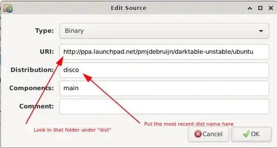

Software sources dialog
Basically such a tool would check all disabled software sources with a comment like "Disabled by upgrade to.." (the exact wording eludes me) then look at the deb source, go out and check which Ubuntu release is the most recent under the "dist" folder, and enter that name in the Distribution field.
Do anyone know of such a tool?
