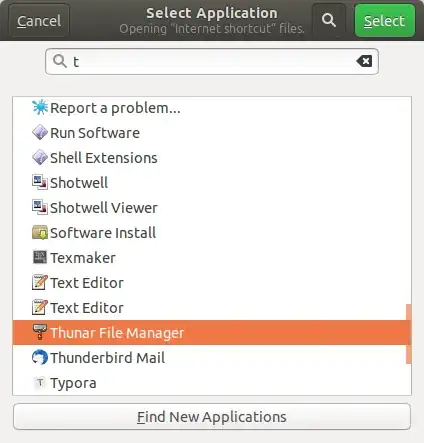

    • Right-click a .URL file
    • Select: "Open With"
    • "Open With Other Application"
    • Select on "Use a custom command" example

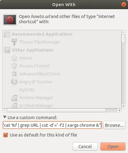

  3. Copy the following command to the text-field: bash -c "cat %f | grep URL | cut -d'=' -f2 | xargs chrome &"
  4. Click the default checkbox.
example.
  1. Press open.
