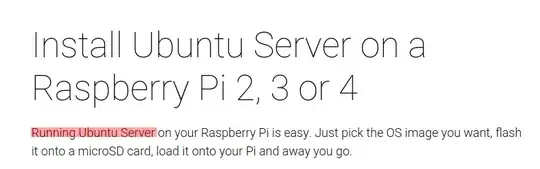

The support for the Raspberry Pi implies that you are installing Ubuntu Server by default. Use tasksel or apt (and friends) to install a desktop environment to your liking.
If you look at the official website you'll notice:
Ubuntu Server explicitly mentioned on the official Ubuntu RPi website
... so you get Ubuntu Server by default.
Oh, and in case you were wondering how to get into the system, simply follow the advice from the documentation:
The login username is "ubuntu", password is "ubuntu". You will be asked to change the password on first login.
From there you should be able to either access tasksel via sudo tasksel or install it via sudo apt update && sudo apt install tasksel. I'm not sure whether tasksel is included by default, as I don't have the image handy at the moment.
