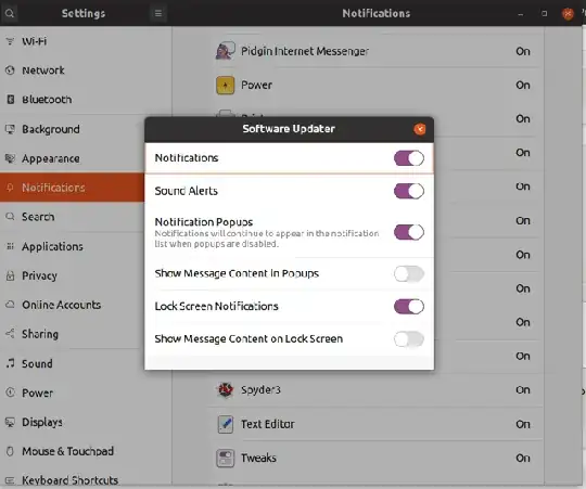

Try two possible options:
  1. Disable from Settings -> Notifications -> Software Updater. Note there is also Settings -> Notifications -> Ubuntu Software with the same settings, I am not certain if it produces the same behavior.
    screenshot
  2. At the command line, gsettings set com.ubuntu.update-notifier no-show-notifications true. You can also set it via GUI with the very useful dconf-editor (you can install it if you don't have it).

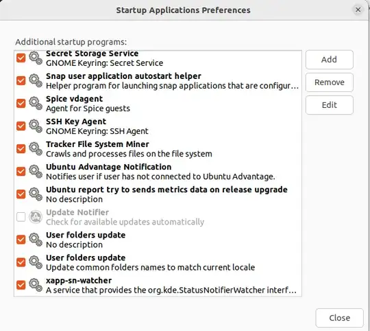

Sergey K
  • 419
The solution is Uncheck the "Update Notifier" under Startup Applications GUI
Step 1: Show Hidden Ubuntu Startup Applications
Terminal:
sudo sed -i 's/NoDisplay=true/NoDisplay=false/g' /etc/xdg/autostart/*.desktop
Step 2: Open Startup Application GUI and find "Update Notifier "
Step 3: Uncheck "Update Notifier "
Step 4: Hidden Ubuntu Startup Applications
Terminal:
sudo sed -i 's/NoDisplay=false/NoDisplay=true/g' /etc/xdg/autostart/*.desktop
