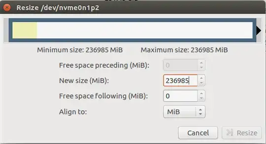

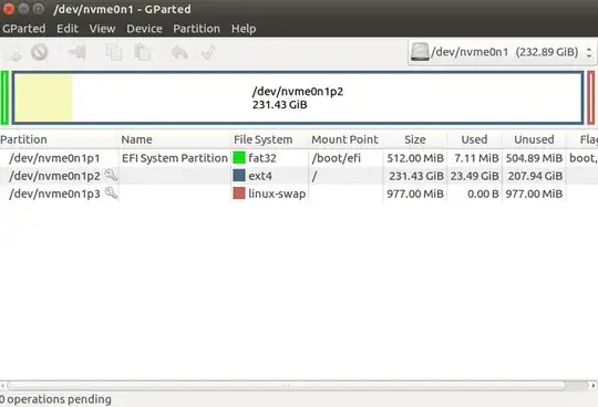

I want to resize this part:
I installed Ubuntu 16.04 and I want to resize this and give an empty memory so that I can install Windows 10.
However, I can't resize it and don't know why.
At first it is dangerous resize system partitions. I also did it recently and worked without problems...so first backup your data...
  1. Download for example ubuntu iso file and create a bootable live usb stick for example with unetbootin or any other software. (In my case it did not work with some usb sticks so try a different one if it doesn't work with the first one)
  2. Boot into the live system with the stick and open gparted or any other partition manager.
  3. Resize the partition (keep in mind the leave some extra space because you maybe need it in the future
That should do the trick....worked greatly in my case (dualboot UbuntuStudio and Kubuntu).
