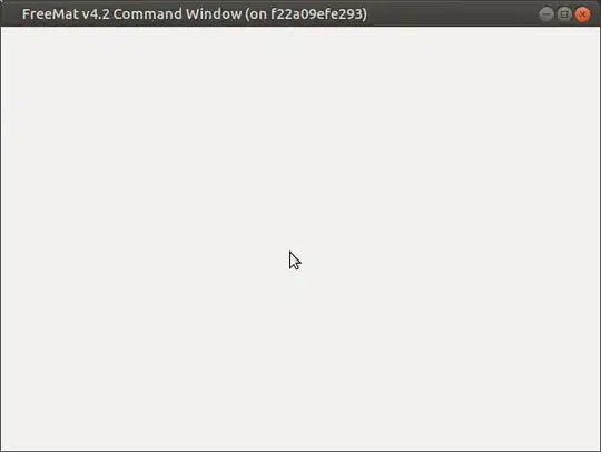

But the FreeMat window is non-functional, instead it looks like:
FreeMat from Docker
and terminal output is the following
X Error: BadAccess (attempt to access private resource denied) 10
  Extension:    130 (MIT-SHM)
  Minor opcode: 1 (X_ShmAttach)
  Resource id:  0x14e
X Error: BadShmSeg (invalid shared segment parameter) 128
  Minor opcode: 5 (X_ShmCreatePixmap)
  Resource id:  0x3200014
X Error: BadDrawable (invalid Pixmap or Window parameter) 9
  Major opcode: 62 (X_CopyArea)
  Resource id:  0x3200015
How to get rid of this error and get application window shown normally and fully-functional?

You can set the option --ipc=host to enable the docker container to communicate with host processes and also accessing the shared memories .
The command to launch graphical application will look as follows:
docker run --ipc=host -e DISPLAY -v /tmp/.X11-unix:/tmp/.X11-unix --user="$(id --user):$(id --group)" ubuntu:freemat
and will show the application window:
FreeMat
MIT_SHM is actually an extension for passing the XImages and some Pixmaps via shared memory. So if the container cannot access that , you cannot open almost any graphical application.
