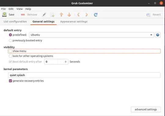

3) After that go to grub customizer and make Ubuntu the default boot in the general setting tab. Tick off show menu and OS probe checkboxes. This will stop you from seeing grub menu even when you chose the Ubuntu option from F12. See the image below. Grub customizer
