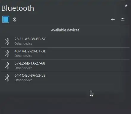

Screenshot of Bluetooth Device Wizard Screenshot of available Bluetooth Devices in the systray
As you can see, the Bluetooth connection wizard does not work properly in (K)Ubuntu 18.04. I'm using an ASUS motherboard (Maximus VII Formula) with a WiFi PCI expansion using a Broadcom chip.
The specific output of lspci -nnk is as follows:
07:00.0 Network controller [0280]: Broadcom Inc. and subsidiaries BCM4352 802.11ac Wireless Network Adapter [14e4:43b1] (rev 03)
    Subsystem: ASUSTeK Computer Inc. BCM4352 802.11ac Wireless Network Adapter [1043:855c]
    Kernel driver in use: wl
    Kernel modules: bcma, wl
Broadcom Inc. and subsidiaries BCM4352 802.11ac Wireless Network Adapter (rev 03)
The WiFi adapter works fine. But it would seem that the Bluetooth adapter has broken functionality.
The only noticeable error is that it lists MAC addresses rather than the names of the devices. I will update soon with the same OS on my laptop to show the difference. It simply does not connect, and with MAC addresses, I am also unable to see which device it is - but I've gone through them all in connection attempts.
