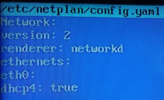

cat /etc/netplan/*.yaml: enter image description here

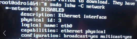

sudo lshw -C network: enter image description here

After trying to install netplan.io we purged netplan. My brother will send the odroid to me then I fight further.

renderer: networkd is used in server installation.
network:
  version: 2
  renderer: networkd
  ethernets:
    eth0:
      dhcp4: true
For desktop netplan uses renderer: NetworkManager and config looks like this /etc/netplan/01-network-manager-all.yaml
# Let NetworkManager manage all devices on this system
network:
  version: 2
You can generate it (but need to remove /etc/netplan/config.yaml before)
sudo netplan --debug generate
sudo netplan apply
reboot
