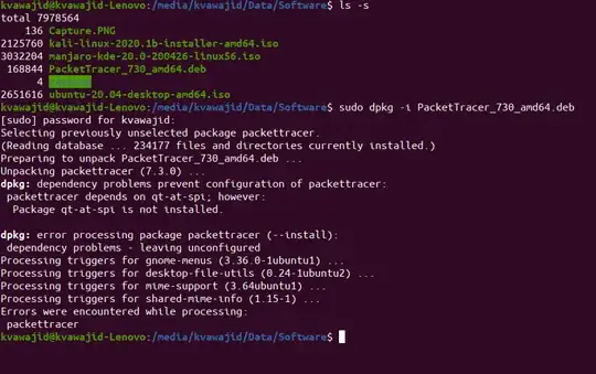

I couldn't install PacketTracer on my Ubuntu 20.04 using sudo dpkg -i PacketTracer_730_amd64.deb command.
as it said you need to install packets it depends on
sudo apt-get install qt-at-spi
however if it depends on something else you should install it too...
it seems it is only on xenial and bionic https://packages.ubuntu.com/source/bionic/qt-at-spi
However you can compile it from git maybe :
https://salsa.debian.org/a11y-team/qt-at-spi
or there maybe any other package it can satisfy the requirement ...
Try to contact with the coder of packettracer ...
