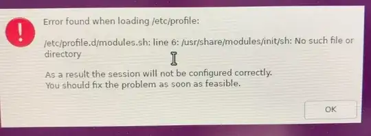

Today I upgraded from Ubuntu 16.04 to 18.04 to 20.04
After Login I get the error
Error found when loading /etc/profile:
/etc/profile.d/modules.sh: line 6: usr/share/modules/init/sh: no such file or dicrectory
As a result the session will not be configured correctly.
You should fix the problem as soon as feasible

But
The path /usr/share/modules does not exist
How to adapt the script?
I did a fresh install of ubuntu 20.04 on VirtualBox and noticed that the file etc/profile.d/modules.sh does not exist in a fresh installation.
So I renamed the file etc/profile.d/modules.sh to etc/profile.d/modules.sh.ubuntu16.04 in order not to be executed
(pattern /etc/profile.d/*.sh within the /etc/profile does not match any more)
After that the error message does not appear any more.
Delete it
The /etc/profile.d/modules.sh script is a remnant of previous Ubuntu LTS releases. It may safely be deleted.
$ sudo rm /etc/profile.d/modules.sh
After doing so, the error message will no longer appear.

On my system, using
dpkg -S /etc/profile.d/modules.sh
showed that file /etc/profile.d/modules.sh belongs to apt package environment-modules.
Using commands to show dependencies on environment-modules, such as
apt-cache rdepends --installed environment-modules
apt -s remove environment-modules
aptitude why environment-modules
showed that environment-modules was actually neither needed by other packages nor even (fully) installed on my system.
Using commands to show historical apt package log data, such as
ls -rt /var/log/dpkg.log* | xargs zgrep install | less
ls -rt /var/log/dpkg.log* | xargs zgrep install | grep environment-modules
showed that, from all log entries mentioning environment-modules, most recently, environment-modules was only "half-installed".
And indeed, using dpkg -l | grep ^rc (see 1, 2) showed that environment-modules was apt-removed but not yet completely apt-purged.
I therefore concluded that it is safe to remove and purge the environment-modules package using
apt remove environment-modules
apt purge environment-modules
This purge did indeed remove file /etc/profile.d/modules.sh from my system. Since then, I got rid of aforementioned error message.
