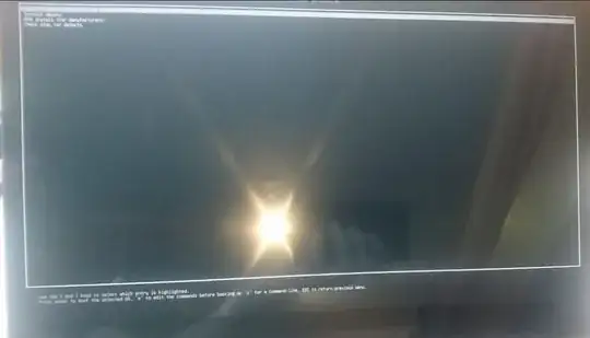

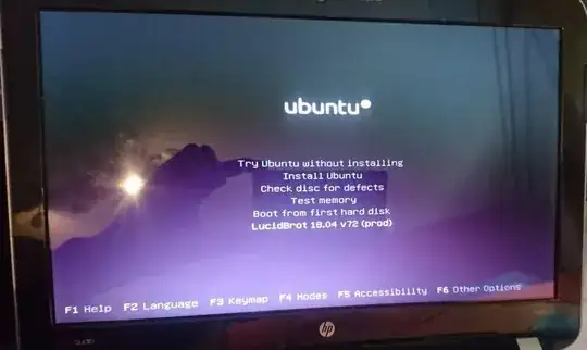

Now, after having set the new laptop's BIOS to UEFI Only Mode, it boots fine into grub, though it looks quite different when compared with how it looks on the legacy BIOS laptop. Most importantly: My custom option is missing.
I am aware that those pictures are quite grainy, but the differences are clear:
Legacy BIOS (old laptop)UEFI BIOS (new laptop)

label install
  menu label ^LucidBrot 18.04 v72 (prod)

How can I make my custom option appear on the UEFI mode boot selection screen?

Writing this question out like that made the suggested "Similar Questions" suddenly help a lot.
For anybody with the same problem:
Edit boot/grub/grub.cfg to contain the same entry as you have in isolinux/isolinux.cfg but use different syntax:
menuentry "Custom Install yey" {
    set gfxpayload=keep
    linux   /install/vmlinuz auto=true file=/cdrom/preseed/my.seed --
    initrd  /install/initrd
set gfxpayload=keep means it won't modify the choice of text vs video graphics.
Place any additional boot arguments on the line that starts with linux.
I have placed my custom entry at the top, right below the line that sets the timout. It has now automatically become the default option.
